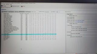

we set  REG0x3F (6000):4800mA,
            REG0x33 (0AFC):  Ilimit2 =110%*Ilimit1= 1.1*4800=5280mA,  ICRIT =110%* Ilimit2=5808mA,

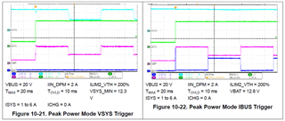

and as REG0x31(323A) settled , we enable peakpower mode , TOVLD 1ms, Tmax 20ms.
So, when input current over 4.8A , it should apply to Ilimit2 5.2A for 1ms , then input current drop back to 4.8A , and battery turn to discharge at the same time till Tmax finish, right ?
But the test waveform show it always keep Ilimit2 31ms not 1ms , and battery discharger 31ms not 29ms (Tmax-TVOLD),  would you please help to check it?
