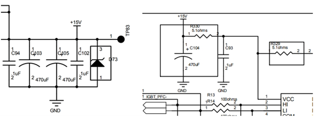

my customer is using UCC27710 on multi locations on a 3kw UPS circuit and a failure occurred on the same position of the board. I have complete the FA report and add some test waveforms for the system. Would you please take a look into this? TI UCC27710 FAR Form-INVT.xlsx

    Based on the schematic, there is a 47uF bootstrap capacitor in place and only a 0.1uF capacitor on VDD. Is there an additional capacitance on VDD as the VDD capacitance is supposed to be at least 10 times greater than the bootstrap capacitance?

    1.VDD is powered by 15V and has two 470uF capacitor in parallel close to it. There is also a 470uF capacitor near to the driver.

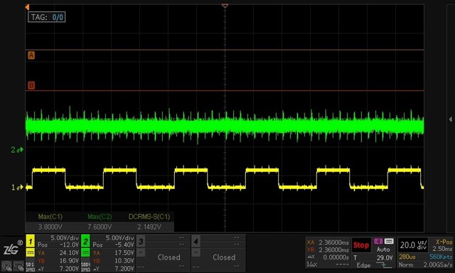

    3.The output of the LO driver is abnormal. The theoretical output is 15V and the actual output is about 2V. The waveform is as follows:
    CH1: LI input waveform CH2: LO output waveform
    Any further information, please let me know. Thanks!

    5. Can you take some scope captures of the start-up and steady state LO and HS measured at the pins of the driver and also measured at the IGBTs? Measuring LO to ground at driver and Gate to Emitter of the Low Side IGBT.

    7. Can you measure the voltage of the VDD supply at the power supply and at the driver pins as well?
    8. The 470uF CVDD capacitor you are referring to near the driver is not shown on the layout snip that was sent to me, can you send a snip that includes that as well?
    ---LO abnormal output 2V. Other signals are normal.

  • 8. The 470uF CVDD capacitor you are referring to near the driver is not shown on the layout snip that was sent to me, can you send a snip that includes that as well?
    ---470uF capacitor is used as energy storage+filter, is far away from failed gate driver.

  • Hey Zoe,
    Thank you for this response with all of this information.
    One of the most important things is having the bypass capacitor near the driver and approximately 10 times that of the bootstrap capacitor. Without that, there can be excessive noise and spikes on these pins which would cause damage. Check out the Bootstrap Circuitry Selection for Half-Bridge Configurations document for some more information this at this Link
