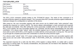

 Recently, our customer needed us to provide a solution to support TPS544C26 programming, but the datasheet says that you must contact the TI manufacturer before you can program the data into the IC. Please provide relevant information, thank you.
