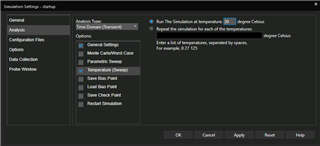

I'm considering setting up a WCCA simulation environment using the Spice model of TPS55288-Q1 supported by TI website.
First of all, I'm checking whether the temperature condition can be changed.
I'm making simulation test bench for assuming Worst case in the operating temperature of TPS55288-Q1 part.
Convergence error is being identified under the conditions of Temp=30.
I would like to ask TI member to check if temperature sweep is possible using TPS55288-Q1 spice model. (Especially for -40 to 125 celcius)
Thank you for your support
BR,
Donghyun Seong
2023/08/28
[Simulation setting]
[spice output about convergence error]

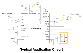

    I have a plan to set-up the WCCA Testbench for TPS55288-Q1.
    I often check these points
    1. Inductor voltgae / current
    2. Current sense resistor voltage / current
    3. COMP node for frequency compensation (with changing passive component values)
    I will try set tolerance for all passive components in my circuit for WCCA.
    And i have a plan to have Monte carlo simulation or Temperatuer sweep for WCCA.

    1. May I know which project you are considering this device in? What is the application and any other project details e.g. volume, schedule etc?
    2. Do you want to check the inductor current peak value as for inductor voltage / current?
    3. As for current sense resistor, do you mean output current function? Do you care about the dc accuracy?
    4. As for the COMP node, do you want to check the loop compensation?
    5. What about using Simplis model for the Monte Carlo simulation?

  • Hi Donghyun,
    Thanks for the feedback.
    You can do the simulation on PSpice for typical analysis, but I think the model doesn't consider the temp variation.
    And for Monte Carlo analysis, I think the Simplis is easier to use than PSpice. But the Simplis model is not released yet, we need some time to do the correlation first.

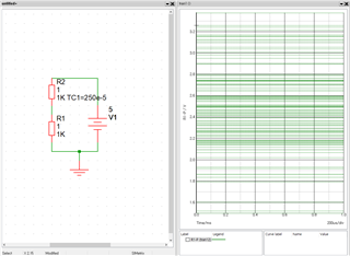

  • Hi Bryce Thank you for your support.
    1.The property editor option of component can be adjusted by changing items (such as TC1, TC2, Tolerance, or PSpiceTemplate)
    2. I tested it yesterday by using SIMPLIS demo ver, and i saw that the temperature sweep & TC variables can be adjusted.
    BRs,
    Donghyun Seong
  • Hi Donghyun,
    Thanks for feedback, very interesting, I have not used that before, just curious, can you show me the simulation file above how to set the Tc and how to get the simulation results?
    Do you have a target date for the simulation file, because we have not finished the Simplis model yet.
    BRs,
    Bryce
