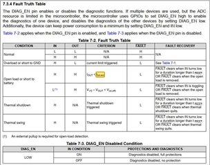

From below table, after DIAG_EN pin is enabled,
Pin IN, we can control by our IOC;
Fault Pin: we can read out by our IOC;
For the OUT signal, does it mean we have to connect to one ADC of IOC, then it can support FULL DAIGNOSTIC?
(Full diagnostic means IOC can distinguish Normal/OPEN load/Short to Battery/Short to Ground state)

  • Hi Shreyas,
    My customer still doesn't understand how this IC differentiates between different fault types (open circuit/short to battery/short to ground).
    From his understanding, if they don't connect OUT to the IOC's ADC, they can't realize this.
    Can you explain how you think it works? Thank you so much!

    Each datasheet has a fault table that describes the conditions necessary to trigger a fault and how it is reported.
    Do note that in our current series of devices, Open load and short to bat have the same electrical signature and cannot be differentiated from one another.
    Short to GND causes current to flow through the device that is greater than the current limit and this results in a fault report.
