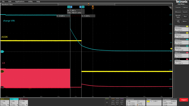

BQ25710: VIN discharge slow after removing adapter, ACOK drops delay cause charging indicator reaction slow
Part Number: BQ25710
Other Parts Discussed in Thread: BQ25720, BQ25700,
Hi Team,
Could you please help check why there is VIN falling time difference, which will cause the ACOK drop delay. I am checking with customer about the Host control logic when removing the adapter, at the same time need check with BU about any advice.

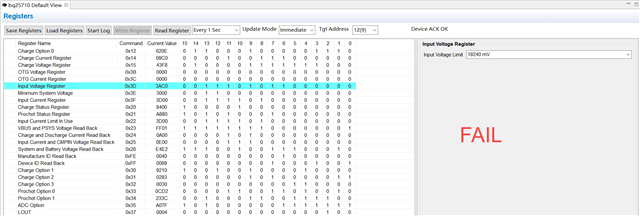

Failed case:

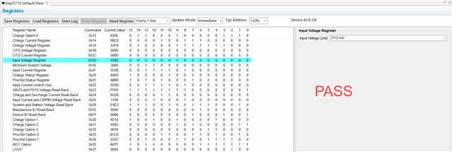

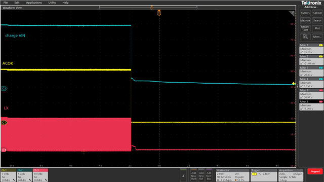

Pass case:
