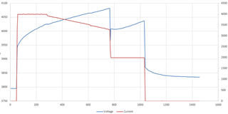

    I have questions regarding the log file.
    Why are you charging as temperature decreases? It is recommended to charge when temperature is stable. Are you manually increasing the temperature in a chamber? A soak time is recommended before start charging.
    It looks like the end of charge current is around 1269-mA. However, in your settings this is set different.
    Can you please send the GPCRB results you obtained? The above parameters should have been updated. The zip file. Also, this tool should have been used according to your application. The data inputted should reflect the application.
    I am curious why the battery voltage drops as the current seems to be "tapering". Voltage should stay constant.

    Please receive my reply for your questions:
    - We are simulating the actual application scenarios of users.
    - The terminal is set to not charge below 0 ℃ or above 45 ℃, the current 1269-mA is not mean the current at EoC.
    - The terminal is set with step charge. When the temperature is 5~45℃, the charge current is about 4000-mA,  When the temperature is 0~5℃, the charge current is about 2000-mA. At around 5 ℃, the battery is in constant current charging mode, After the temperature drops below 5 ℃, the charging current      decreases, resulting in a decrease in voltage.

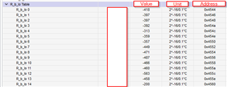

  • Hello Tony,
    Please see below the Rb table addresses so that you can read and write to.
    I have scaled the Rb table to the new ratio. You may read from the addresses to confirm. See the srec attachedhttps://e2e.ti.com/cfs-file/__key/communityserver-discussions-components-files/196/Rb_5F00_low.srec

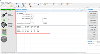

  • Hello Jose,
    I'm sure the smoothing is set.
    I tried to read the value of Rb using Advanced Comm I2C of bqstudio, but I don't know what's the start register. Please help me to input the command in the
    attachment figure. And the value read out in this way should be in hexadecimal. How to convert it to decimal?
    thanks a lot.
    Best regards
    Tony
  • Hi Tony,
    I2C address is AA
    Start Address is 3E
    Bytes to Write is the address of Rb
    Number of bytes to read is 2
    An example of writing to data memory can be found in the Gauge communication app note. Section 4
    Also, please reference to this Thread
    Jose Couso
  • Hi Jose
    The updated srec is very helpful to me, thank you.
    But there till are some questions need your help:
    1.The RSOC jump is still exist,  but looks like there's been some improvement.(At the beginning, RSOC jumped from 34% to 4, and now it has jumped from 71 to 67)
    2.Unable to read any information when sending instructions to read the value of Rb.
    3.Can we change the value of Rb ourself? and how can we do it? I don't quite understand the Gauge communication app note.
    4.How do we enter the interface shown in Figure 2 of the attachment.
    Looking forward to your reply, thanks.

  • Hi Tony,
    1- Do you have a log to analyze what is happening?
    Please send the srec. I can further tweak the Rb table. I will need the input data you used for the GPCRB tool.
    3- Please see this thread for detailed example.
    4- These are private parameters. But with the given addresses you can change the values.
    Please provide the files in the first bullet.

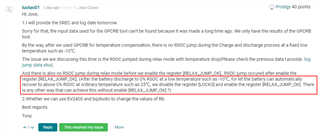

  • Hi Jose,
    1.I will provide the SREC and log date tomorrow.
    Sorry for that, the input data used for the GPCRB tool can't be found because it was made a long time ago. We only have the results of the GPCRB tool.
    By the way, after we used GPCRB for temperature compensation, there is no RSOC jump during the Charge and discharge process at a fixed low temperature such as -10℃.
    The issue we are discussing this time is the RSOC jumped during relax mode with temperature drop(Please check the previous data I provide .log jump data.xlsx).
    And there is also no RSOC jump during relax mode before we enable the register [RELAX_JUMP_OK]., RSOC jump occured after enable the register [RELAX_JUMP_OK]. (After the battery discharge to 0% RSOC at a low temperature such as -10℃, for let the battery can automatically recover to above 0% RSOC at ordinary temperature such as 25℃, we disable the register [LOCK0] and enable the register [RELAX_JUMP_OK]. There is any other way that can achieve this without enable [RELAX_JUMP_OK] ?)
    2.Whether we can use EV2400 and bqstudio to change the values of Rb.
    Best regards
    Tony

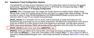

  • Hi Tony,
    FCC dropped drastically, this is the reason of the RSOC drop. The gauge will stablish FCC based on temperature and load. At lower temperatures, there's expected to be less capacity.
    RSOC_HOLD and SMOOTH cannot be set at the same time. This causes erratic SOC behavior. Often we suggest to set SMOOTH
    Please clear the RELAX_JUMP_OK bit.
    We do not reveal the Rb table. I believe this is not the problem. I can always further tweak the Rb if you provide me the input data of the GPCRB tool.

  • Hello Jose:
    erratic SOC behavior-Can it be more specific? How will it become erratic?
    Perhaps I didn't express myself clearly, this register needs to enable as follows.
    You means we can use EV2400 and bqstudio to change the values of Rb?
    I logged the room temperature and low temperature charge and discharge data again for GPCRB as follow attachment:
    low temp and room temp data.rar
    We used two samples discharging at -10℃ with the updated srec of Rb, and the RSOC will significantly jump. The data as follows. And for sample 2, I exported the srec and gg file before and after discharge.
    sample 1.rarsample 2.rar
  • Hi Tony,
    I received the data, I will get back to you.
    We have seen customers report this. We suggest not to set RSOC_HOLD and Smoothing together. See below the documentation for a different gauge which uses Impedance Track as well.
    You can write to the Rb memory location I provided earlier. I will double check the data you provide to see if further tweaking is necessary.
