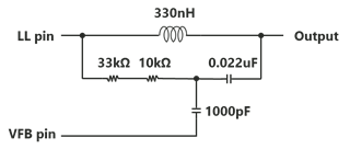

    The ripple injection circuit is shown below. Using the design tool, I changed the resistance from 43 kΩ to 20 kΩ, but the output voltage waveform did not change. Please let me know if you have any other concerns.

  • Hello Yuta-San,
    After taking a look at your schematic I have a few ideas.
    1. Can you make sure that the output is not shorted? The frequency at which the pulsing is happening makes me think that there is a capacitor that is shorted, or maybe a resistor. This can be done by applying a small current in reverse to the output while the device is off. If one of the capacitors is shorted, it will get hot, which you can identify on a thermal camera. You can also double check this by putting a multimeter across the capacitor bank and measuring the resistance.
    2. I would lower the ripple injection resistor to 10kOhms just to see if anything improves, otherwise your ripple injection circuit has no issues.

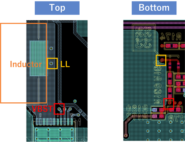

    3. On the layout, can you confirm that the connections to VBST and the Snubber are not shared through a single via on the switch node?
    Caleb
  • Hi Caleb-san,
    2. The customer changed the value of the ripple resistor to 10kOhm and saw no change in the output voltage.
    3. The vias are arranged separately. Part of the pattern layout is also attached, so please check it.

  • Hey Nishie,
    Layout looks good. Did the customer have a chance to check for a short on the output?

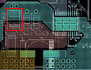

  • Hi Caleb-san,
    Additional information was obtained from the customer.
    After removing the ferrite bead (BF1) from the schematics posted in the past, the output voltage is normal. If you press the FB pin of the DCDC on the front stage of the TPS53355 with your finger, the output voltage is normal. However, the FB1 cannot be removed in the customer's circuit.
    If you have a solution, please let me know.
    Nishie

  • Hi Caleb-san,
    Thank you for your reply.
    A few questions for you. When you remove the ferrite bead do you put a short in its place?
    ->When the ferrite bead was removed, customer put a short in its place.
    And what FB pin are you talking about, the FB pin on the device or the pins on the ferrite bead?
    ->The FB pin is the FB pin of DCDC that generates 12V.
    Next I ask that you ask the customer to verify the location of C15, we are wondering if the location of this cap in relation to the VDD pin may cause issues
    ->I would appreciate it if you could check the attached pattern layout regarding the position of C15.
    TPS53355 Pattern Layout.pdf
    Also, can you ask the customer to measure VIN at a cap that is closest to the device, preferably with a differential probe? It looks like the scaling is off on the initial VIN oscilloscope screenshot you sent, so we are wondering if this was an error. Can you provide a screenshot of the VIN caps in relation to the VIN pins as well?
    ->I will check the Vin.
    Nishie
  • Hey Yuta-san,
    I cannot find C15 on the layout you shared, it looks like VDD is connected directly to the VIN pad without its own filtering resistor. This may be the issue. Can you explain the discrepancy between layout and schematic?
    Caleb
  • Hi Caleb-san,
    I apologize for the difference in pattern layout numbering from the previously shared circuit diagram. C15 is the same as C452. The red frame in the figure below represents C15.
    Nishie
  • Hey Yuta-san,
    This may be a reason that the device is unstable at no load. The VDD capacitor is required to be as close to the device as possible in order to effectively filter out noise. The VDD pin is the input supply for the device controller circuitry. Can you ask the customer to somehow bridge a capacitor near the pin to ground?
