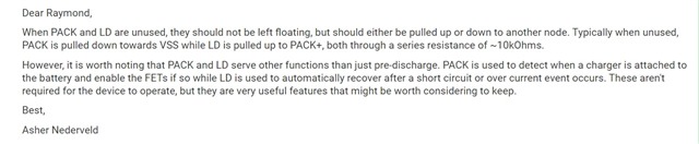

Hi, when i am not using the PACK & LD Pin where should I connect to?
The manual and forum advice are totally different as attached.
Please advise.
From the manual:
From the forum:

Hi Raymond,
The section from the manual that you have attached is referring to a situation where you do not have high-side FETs, which affects how some of the voltage nodes respond to the FETs opening and thus requires special considerations for where the LD and PACK pins are connected.
Asher's response on the forum is for a situation where you still have high-side FETs, but do not want to use the LD and PACK pins' functionality.
For your situation, follow the instructions detailed in Asher's forum post.
