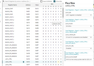

    so you are correct with the register LDO2_CTRL (0x1E), the LDO2_SLOW_RAMP is a bit field in the register specifically position 1 out of the 8 possible bits [7:0].
    I want to set TPS6594EVM "LDO-2 SLOW RAMP" as 3mv/us, but I don't find which register can be set in the datasheet for "LDO2_CTRL", could you tell me which register can I set?
    To set it in the GUI while it is up and running you can go to the register page in the GUI, go to the address 0x1E and flip the bit.
    Now that only changes it after it boots up and if the power goes off then it is not saved, if you would like this to be the default behavior upon boot up you need to go through the NVM configuration like you have in your post.

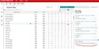

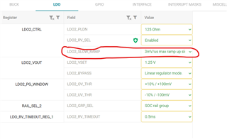

    and I want to set by the GUI, it is still fail.  but if I change "LDO2 VOUT" voltage from 1.25V to 2.7V, it is ok. just like only SLOW RAMP register can not be set.
    Are you trying to change the settings in this screen and see the changes done from the device?
    If so my apologies, this screen is reserved for changing the boot up configuration (NVM), to change the settings after boot up you, you need either use the quick start settings (thunderbolt on the left side of the screen) or the register settings page (pencil on the left side of the screen).

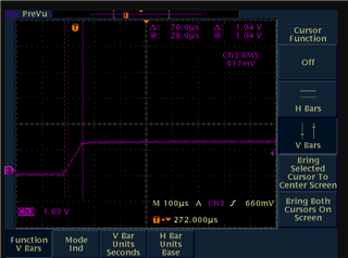

  • yes, I according to you suggestion, and change my .json file
    and download it, check the NVM configuration, the LDO2_CTRL -  LDO2 SLOW RAMP is 3mv/us,
    but I test LDO2 RAMP time, still is 25mv/us
  • the datasheet shows "LDO2_CTRL Register" -- "3:1" bit is RESERVED,  it  means we can't change it?
    Yes, reserved means that we shouldn't write to these bits as may have unintended behaviors.
