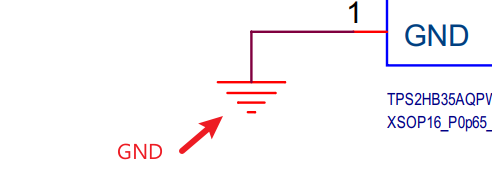

   There is a high side IC TPS2HB35AQPWPRQ1 in our design,this is the first time for us to use this chip  So can you review the schematics for us?
For TI REVIEW.pdf

    1. I notice that there is no GND network used here. Is there upstream reverse current protection? The device requires a GND network to support the reverse polarity event if there is no upstream protection.

    1.  I don't understand what no GND network means, this symbol represents the GND network in the schematic diagram

    Please view section 9.3.1.5 in the datasheet for more information about a GND network. This is a diode in parallel with a resistor that connect between the IC ground and the module ground to allow the device to survive negative voltage events like reverse battery.
