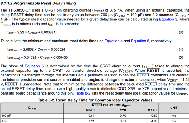

Hi team,
Would like to check one question for TI TPS3850.
  • We would like to connect WDO of TPS3850 to NMI of SoC (DRA78x) as data sheet describes.
  • Due to we cannot disable NMI once it is enabled unless code-reset is triggered (TI SoC issue/limitation), in NMI ISR (Interrupt Service Routine) we have to dessert WDO immediately before triggering warm-reset.
  • I try to disable TPS3850 via SET1 and SET0, but the WDO will still keep asserted for 10 ms. Do you know there is a way to shorten WDO active time?
