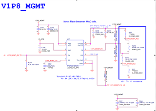

Customer used TPS74801 for 1.8V core power and used many MLCC capacitors.
They worry if too low ESR might affect loop stability. Is there a maximum output capacitance guideline and may need Cff in what condition?
Do we have any calculation tool can help estimate value of Cout and Cff for transient analysis?
