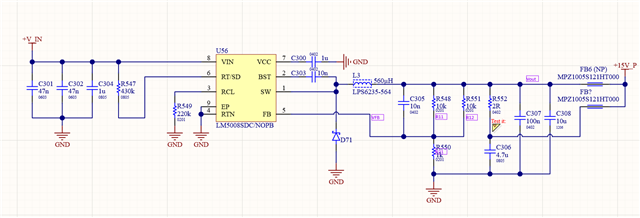

I am using LM5008 to regulate 18V to 95V input into 15V as depicted in the schematic below.

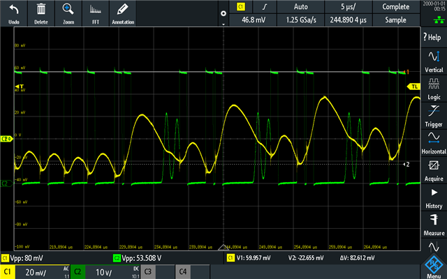

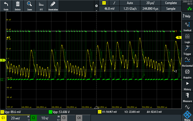

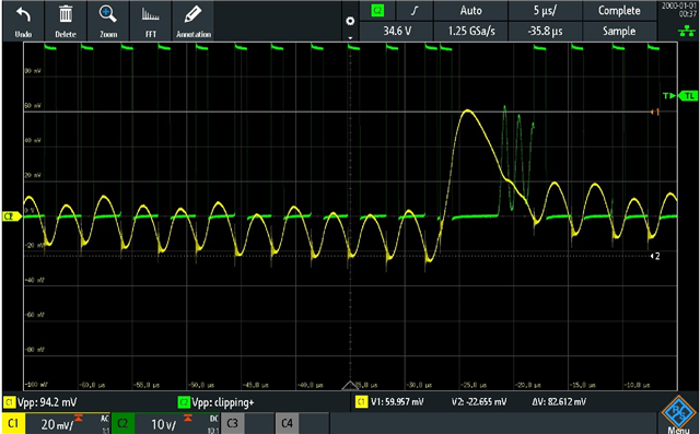

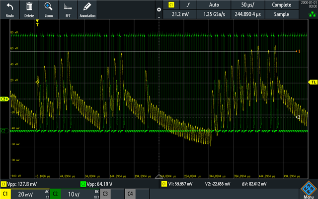

Channel one is the ripple signal of the output and channel 2 is the switching node signal.
 For 49V and 42mA:
For 60V, 47mA:
  • Please consider that I am measuring V_out on C308.

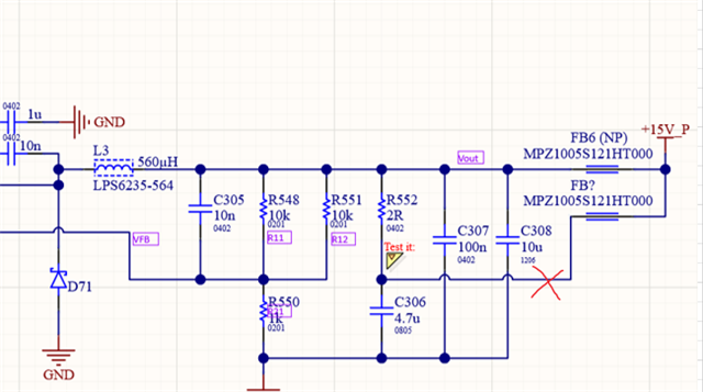

    Pls cut the connection like below shown. I suspect the two output ripple can be overlapped and this can cause ripple out of phase ,so SW will be unstable.
    Colin
  • Hi Colin,
    Thanks for the reply.
    Clearly, those FBs are not placed, and they are used to testing them separately in our circuit. For the tests that I am now doing, those FBs are not placed, and an electronic load is connected to Vout net (across C308).

    I think you still met unstable issue. The R552 =2ohm is too high and this may cause output ripple too big. Some  noise may become bigger as well and it may fed into FB pin. So you can reduce R552 from 2ohm to 0.2ohm and test again.
    Colin
