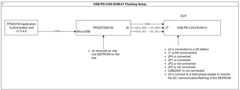

I am flashing the EEPROM on the USB-PD-CHG-EVM-01 with the following configuration provided from the TPS257570 Application Customization Tool v7.0.4.6:
{"questionnaire":{"version":"7.0.4.6","answers":[0,2,2,0,0,null,1,null,1,null,0,8.2,2,0.4,0.4],"options":{},"configID":"0000","vendorID":"0000"}}
In this configuration, I would expect the development board to Source power to a phone, and Sink power from a PD power supply from the attached 2S battery.
However, when I plug this configuration into a power supply, the battery does not charge. Here are the PD negotiation and BQ25792 I2C logs.PD Negotiation from wall power supply.csvBQ25792 I2C Communication from TPS25792 with wall power supply.csv
and, when I plug this configuration into a phone the phone does not charge. Here are the PD negotiation and BQ25792 I2C logs. This behavior repeats every second or so. In the log, I disconnect the phone after a few repeats.

    Can you send me the .JSON file, and can you explain how you flashed to the EVM.
    Christian.
  • Hi Christian,
    Here is the contents of the .json file:
    Here is the zipped .json file:
    3630.config.zip
    As for flashing, I am using the TPS25750 Application customization tool v7.0.4.6. This is my setup:
    I have also verified the EEPROM's memory after flashing using an external EEPROM flashing tool. The flash memory read matches the Generated Full Flash Binary from the above config.json. Here is the generated full flash binary:
    Full Flash Binary.zip
    Nate
