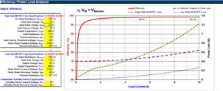

Hi!
I am designing buck from 75-40V (avg48V) to 36-5V (digipot trimmable) 8A load
I want to use two gan3r2-100cbe for high and low side.
But what's confusing me, is that I see in each ev board design (also webench):
Lower Rds and higher Qg for high side
And higher Rds and lower Qg for low side.
I tried to find why and didn't succeed. Only reason I see is cheaper design.
And probably it is also about Ton Toff sequence.
Can You explain me?
Basic question: may I use identical MOSFET for high and low side?
Should I care about Ton Toff, or controller does itself?
My main goal is highest effecient design because of thermal requirements.
I see that the lowest Qg and Rds I have the better is efficiency.

  • Thank You so much for answer.
    In my application there will be trimmable output voltage IN:50V OUT:36-5V 10A.
    My duty cycle can go from 0.1 to 0.8
    IMPORTANT: I also found out, that LM5146 is not fgood with GaN transistors, because usually they have Vg max=6-7V, but LM5146 is 7.5V output drive.
    So I give up with GaN (even they have the best Qg and Rds).
    Now the best efficiency/ power loss on MOSFET i get on this MOSFETS: ISC0805NLSATMA1 Rds=7.8 mOhm, Qgd=4.7 nC
    I will put these MOSFETs on high and low side, seems like the best solution I found on the market with Rds/Q tradeoff
