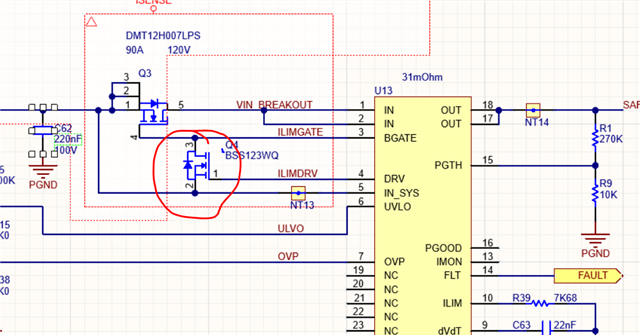

The schematic for a single channel is:
The layout is:

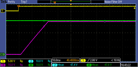

    Thanks for taking the time to give this a look. I don't have a great scope (DPO2024), and it's a bit out of cal, but here you go.
    This is for a channel that is not working. The output is driving a 22 Ohm resistor.
    Yellow is SHDN. Pink is VOUT. Green is VIN_SYS, and Blue is VIN (pins 1&2).
    In the above shot, you can see that output comes on as expected when SHDN rises. You can also see that both VIN, and VIN_SYS are high throughout and if you squint a bit, you can almost make out that VIN is ever so slightly higher than VIN_SYS. This scope's measurement function leaves a bit to be desired, however, the mean measurements of channel 2 (VIN) and channel 4 (VIN_SYS) would seem to indicate that the pass transistor is not on.

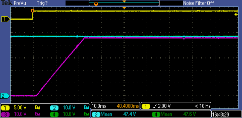

    Ok, so the next two shots are looking at BGATE (green) and DRV (blue). They are both from the same edge of SHDN event, the difference is whether the Green or Blue are in front, and that is just to basically show that they are pretty much at the same voltage (neither is turning on a FET).

    1. For all the channels VIN and VOUT is independent? I mean no short among VINs or VOUTs
    2. Exactly same schematic for all channels?
    3. It is possible that this DRV FET is showing some issue on other channels and because of which VINSYS and BGATE are getting shorted?
    Kunal Goel
  • Hi Kunal,
    Had some vacation, so sorry for the long delay.
    All channels have independent VINs and independent VOUTs and have exactly the same schematic. It should have been mentioned that we are attempting to modulate some data on the VIN (2-4 volts), and this modulation is likely the culprit of the problem as it lowers VIN briefly.
    Management decided to rip these two transistors out because they are not absolutely required for our application, and we need to move forward. So while we do not have a NP complete proof of exactly what was happening, this issue can be considered to be resolved.
