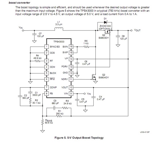

TPS43000 - max current question?
I'm faithfully reproducing the  boost only converter on p18 of the data sheet.  It states input voltage range 2.5V to 4.5V and 5V output which is perfect for boosting the voltage from a lithium ion battery.  However it states a load current of 0 A to 1 A?  I cannot see how the current is limited to this range as surely this is a matter of inductor and mosfet selection?
I've chosen parts which should allow me to draw up to 6A safely with nearly twice this number for a safety buffer.
Thanks!
