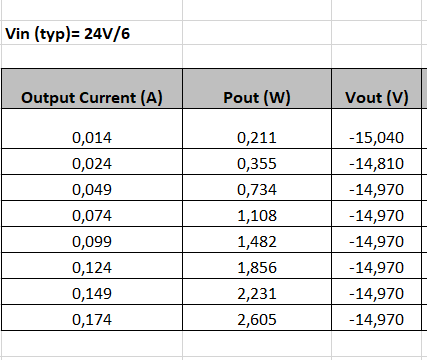

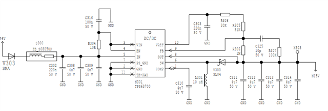

i am using the TPS63700 DC-DC inverter to generate -15V output voltage (0.15A) from a 6V as in the schematic bellow (fig 1), the Diode dropout the input Voltage to do not exceed the maximum input Voltage,

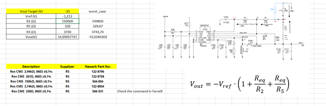

I am getting -16.4V instead of -15V, i have tried feedback resistor combinaison by setting R308 + R305 to 161KOhm and  R306 to 2Mega Ohm and still not got the required output voltage (resistor tolerance is +-0.1%).
 i've checked the Vref which seems to be ok (1.213V) the Schottky Diode breakdown voltage is 30V, i've also changed the C310 to 4.7nF as recemanded and anlso isolated the circuit and applied directly a 5V input Voltage but i still not got -15V output voltage.
fig1:

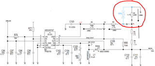

I have also tried the configuration bellow but still got no -15V
Do you have any suggestions ??
