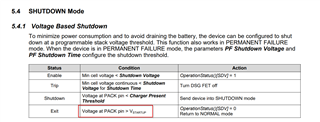

    The BQ40z50 is waked up from shutdown by applying a voltage at the PACK pin greater than a Vstartup threshold specified in TRM (typically ~3V).
    The action of pressing the WAKE button in the Evaluation Board bypasses the protection FETs and assuming that the battery is attached, it will wake the device. See below.
    In the final design, the pack should be able to wake up when the external charger voltage is connected to the BQ24800. How can we implement this?
    I am not sure how you connect the BQ24800 charger IC, but if this is connected to PACK+ from the BQ40z50 EVM, it will apply a voltage high enough to wake the device. It is important to know that the device will enter shutdown mode again if the min cell voltage is less than Shutdown Voltage (see the first picture).

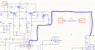

    Looking at the schematics of BQ40Z50EVM, you wake up the battery by pressing the wake-switch - putting a voltage on pin 27, PACK, of the BQ40Z50. Since the switch is not applicable in the final design, there have to be antoher way to get a 'wake-up' voltage on that pin.
    If you want to wake up the battery via the charger but the BQ24800 is not operational (default values) the easiest way is to connect the BQ24800 input, 'Vin' on the BQ24800EVM, to pin 27, PACK, from the BQ40Z50.
    I suggest a diode + resistor from 'Vin' (BQ24800EVM schematic) to R12 (BQ40Z50EVM schematic) and adding a diode from 'PACK+' to R12 on the BQ40Z50EVM.
    So if the BQ40Z50 is in shutdown mode it remains there till there is an input voltage applied to the BQ24800, going through 'diode + resistor' to R12. This diode prevents leakage current from 'PACK+' to the BQ24800 input when there is no voltage applied and the battery is active.
    The diode from 'PACK+' R12 prevents current from the charger input (Vin) going straight to 'PACK+'.

    I made the modification Rob and you suggested on your BQ24800 EVM which is connected to the BQ40Z50 EVM.
    I connected the charger input voltage via a 10k resistor and diode to the pack pin of the BQ40Z50. I also added a second diode between the pack pin and the existing pack pin resistor to prevent the first diode charging the battery.
    The charger presence detection when the pack is in shutdown works, but the gauge now reports a lower 'PACK pin voltage'. As expected the 'PACK pin voltage' drop is equal to the voltage drop acros the diode which is about 180mV.
    Does this affect the operation of the BQ40Z50 in any way since it now measures the wrong voltage? Are any wrong assumptions/calculations now being performed internally?
    Update: when the charger input voltage (thus the voltage on the diode connected to the PACK pin) is raised above Vbat+CHGV:Threshold*amount of cells (i.e. 22V), the gauge detects a pack voltage higher than the inteded charging voltage which trips the CHGV bit that stops the charging. How to solve this without bypassing protections?
    Kind regards,
    Svenn
