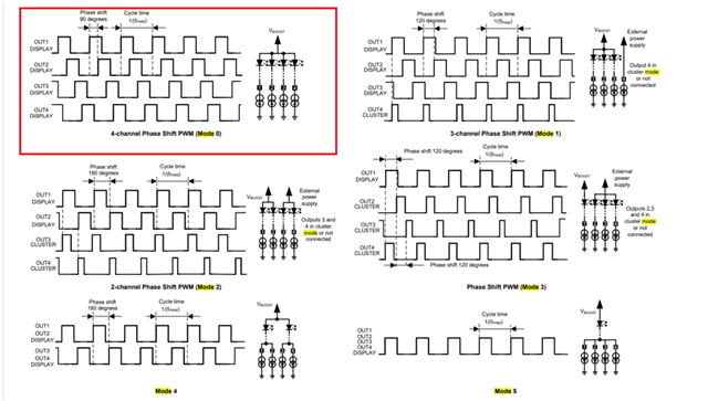

LP8860-Q1: Just use three output channels, in the case of MODE 0, will it report a fault? What is the status of OUT4?
Part Number: LP8860-Q1
Hi team,
If the customer only uses three strings of backlight, will there be any problems if mode0 is selected, will there be an error message, OUT4 is not connected in MODE 0 state, what is the state of OUT4?
Is it necessary to choose mode1? Thank you
