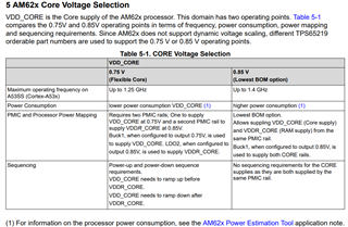

    Thank You for using E2E. We do not have any PMIC NVM variant with a Buck and an LDO configured to output 0.85V. The reason is because VDD_CORE and VDDR_CORE are expected to be powered by the same source so they ramp together when VDD_CORE is operating at 0.85V. This last statement is noted in the AM62x data sheet. When using TPS6521904, both VDD_CORE and VDDR_CORE must be supplied by the PMIC Buck1.
    Why would you need to change the voltage on Buck1? Could you provide more information on this? The AM62x processor doesn't support dynamic voltage scaling and the 1.8V VPP rail for eFuse is supplied by a discrete LDO (external to the PMIC). Here is more information on the VDD_CORE voltage selection:
    https://www.ti.com/lit/an/slvafd0b/slvafd0b.pdf

    Since AM62x doesn't support dynamic voltage scaling, we have a different TPS65219 orderable part number to support each VDD_CORE voltage. TPS6521904 can be used for 0.85V and TPS6521903 can be used for 0.75V.
    Additionally, I have checked with the Sitara processor team about the CORE requirements for USB DFU backup up. They have done the required analysis to confirm 0.75V on VDD_CORE works for DFU. Let us know if you see any issues.
