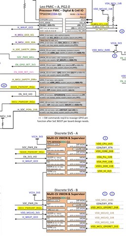

  • The J784S4/TDA4VH EVM detailed PDN-3A diagram (snapshot below and the entire diagram is available on CDDS per link:
    CDDS: Folder - Jacinto7 Product Series/J784S4/EVM/J784S4 EVM Single Leo + Dual HCPS PDN-3A:
    US - https://cdds.ext.ti.com/ematrix/common/emxNavigator.jsp?objectId=28670.42872.33731.19705&latestRevision=true
    The PDN-3A diagram shows the key interface signals & power rails monitored by Safety Voltage Supervisors (SVS-A & SVS-B). SVS-A monitors all SoC Main processing domain input supplies that are sourced from discrete power resources (not from PMIC). While SVS-B monitors all SoC MCU processing domain input supplies that are sourced from discrete power resources (not from PMIC).
    The PMIC has two GPIO inputs connected to each SVS by nets "MAIN_PWRGRP_IRQn" and "MCU_PWRGRP_IRQn".  If an OV/UV error occurs on the Main processing domain input supplies, the SVS-A will assert MAIN_PWRGRP_IRQn low and PMIC state machine will transition to MCU Only mode of operation (only the MCU power supplies remain energized). This allows the PMIC INTn to notify TDA4 MCU R5 that an "issue" has occurred and MCU can investigate source of the INT via I2C bus. The MCU Only mode of operation enables the "safety processor" functions to be supported independently from SoC's Main domain processing.
    If an OV/UV error occurs on the MCU processing domain input supplies, the SVS-B will assert MCU_PWRGRP_IRQn low and PMIC state machine will transition to Safe State of operation (all Main & MCU power supplies are disabled). This puts the entire system in a Safe State as soon as possible since a fault within the MCU/Safety Processor has been detected.

    Snap-shot of J784S4 PDN-3A:

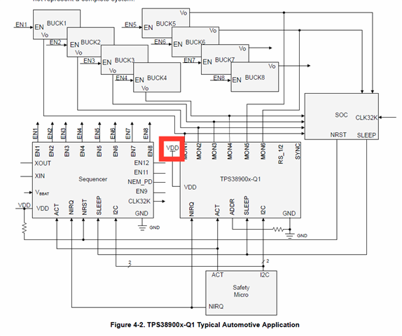

    Jinliang Reply: The Monitors from MON1 to MON6 are used to detect the voltages applied to TDA4. But I wonder if there are any SMs inside the 389006 to detect the input voltage of itself, as remarked in below picture.
    If there are no SMs inside the TPS389006 to protect the input voltage itself, what is the system's action when there are UV fault, according to the reference design?

  • Hello Junliang,
    TPS389006 does not have a safety mechanism to monitor its own VDD, there will have to be another element in the system to account for that type of fault. I will let Bill comment if this case is accounted for at the system level.

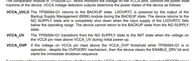

  • the PMIC in the reference design provides monitoring to the VDD rail of the supervisor.
    Hello, Oscar
    According to the reference design, PMIC TPS6594 and the supervisor TPS389006 have the same power source.
    -In the safety manual of TPS6594, the PMIC has the internal SM to protect its input voltage:
        The 6.3.9 SM9—Redundant UVLO/OVP Input Voltage Monitor on VCCA indicates that PMIC will shut down when UV & OV is detected.
        The 6.3.10 SM10—Input Over-Voltage Protection (VSYS_SENSE, OVPGDRV) indicates that PMIC will shut down the power input when OV is detected.
    -In the safety manual of TPS389006, 0ne AOU requirement is as follows:
        [SA-3] The system will meet the data sheet requirements for voltage and current for the supply input of the TPS38900x-Q1. In the event of voltage error, the system inluding TPS38900x-Q1 will be transistioned to a safe state.
    Now my question is: How does the current design meet this AOU when UV fault is detected?
    Thanks.

  • Hello Junliang,
    I apologize for the delay from my side. I was reading through the TPS6594-Q1 datasheet and noticed the following section on page 47 of the datasheet which speaks about the PMIC behavior in the case of a UV event, I thought it might be useful information.
    Additionally, I have spoken to the team about this query and was wondering would you be open to a secondary supervisor to monitor the VDD power rail? doing so I believe would give you the flexibility to influence the safety concept of the system to meet your needs.
