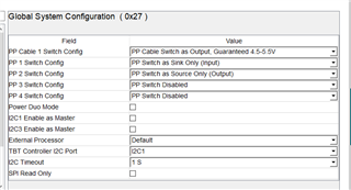

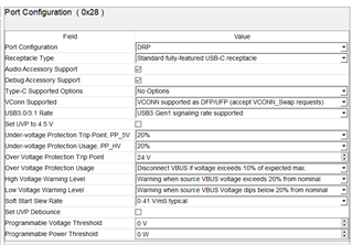

    I just took a look at your configuration register snapshot you sent, and it looks like the configuration changed from the project file I sent. I see that the port is actually disabled and in the source PDOs, the only source PDO is at 0A max current. I am not sure what happened there. It could be just a communication issue, as I have seen similar cases in debug mode. Can you send me a screenshot of registers 0x27 Global System Configuration and 0x28 Port Configuration not in debug mode. I just want to confirm the settings are still correct in your project.
    Alex
  • Hello Alex-san,
    I attached it,
    Yukio Oyama
  • You might also want to check you ADCIN resistor divider setting. If that doesn't match then the configuration would not load properly.
