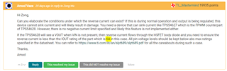

  • Hi Zong,
    Can you elaborate the conditions under which the reverse current can exist? If this is during normal operation and output is being regulated, this device cannot sink current and will likely result in damage. You need a device that can sink current like TPS54627 which is the FPWM counterpart of TPS54628. However, there is no negative current limit specified and likely this feature is not implemented either.
    If the TPS54628 will see a VOUT when VIN is not present, then reverse current flows through the HSFET body diode and you need to ensure the reverse current is less than the IOUT rating of the part which is 6A in this case. All pin voltage levels should be kept below abs max ratings specified in the datasheet. You can refer to https://www.ti.com/lit/an/slyt689/slyt689.pdf for all the careabouts during such a case.
