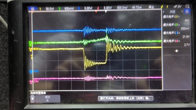

Whether this Vaux voltage across 0V 3 times(when DRV turn-off) will cause to UVLO fault? I found some materials in TI.com, shown as Fig.1 and 2.
Customer find their system happened stop, and wavs is shown as Fig.3. Could you please help check this case? Thanks.

Bule is VDD, green is CS, yellow is Vaux, red is Flyback output.
