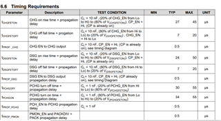

     Please help confirm the current drive capability of the MOSFET drive pin of BQ76200, including instantaneous drive capability and steady-state drive capability.
     According to the datasheet, if i use the dv/dt*C=I, the output current from the DSG would be 4mA. Am i right?

  • Hello Nan,
    The exact current capabilities for the charge pump were not characterized and it may vary based on load. It can be estimated based on the rise time/fall time and load used.

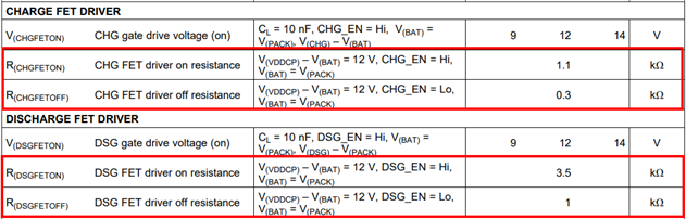

         Q2.We want to calculate how much the current is from Cvddcp. So the Vddcp equals Vbat plus 9-12V. So the driving current via DSG is Vddcp/(Ri1+Ri3+Rdsg).So the question is how much the Ri3 and Ri1.
    The DSG/CHG on/off resistances are in the EC table:

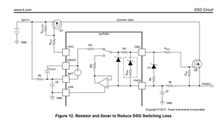

  • Hi Luis,
          In this picture, the customers are concerned that the leakage current through the Rsg would provide a voltage which could open the MOS_DSG.So they want to reduce the value of Rsg. In our reference design, we recommend Rsg as 10MR. Could you please help me to figure out that how much the customers could reduce the value?
        I will verify their application where they use our bq76200 after figuring out this issue.
    YOURS
    NAN
  • Hello Nan,
    Unintended turn-on is unlikely. When the CHG FET is OFF, it connects to BAT+, so the voltage different between the gate and source of the CHG FET will always be ~0-V. The DSG FET when OFF will connect to PACK+, so the voltage difference here also is ~0-V.
    So leakage current would have to be significant enough to overcome these, which is unlikely. These are also N-Channel FETs, so the Vgs voltage is what would determine if it turns on or not.
    Regarding the 10-MOhm, I would not recommend to lower this at all. As I mentioned previously, the charge-pump can output roughly ~40-uA. So 10-MOhm was chosen to keep the current consumption low and to not overload the charge-pump.
