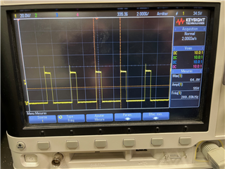

Below the signal that we get on pin Vswitch.
We have an overshoot at 65V but nothing much
We used two Schottky  diode in our design (in both cases we have issues)
From 2013 to 2016 : SK310A from MCC
From end of 2016 : MBRAF3200T3G from NSEMI
Not sure if it shows anything peculiar.
