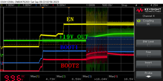

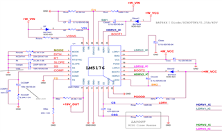

We use LM5176 to realize Vin 9V~36V, Vout 19V/6.5A, but now the output voltage is just 3.37V. The schematic is as below:

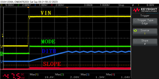

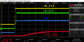

We measured the voltage value as well as the waveforms of each pin as follows:
Net Name Measured
+W_VIN 20.4V
+W_VCC 8.11V
EN 3.19V
+19V_OUT 3.37V
VIN 19.6V
MODE 2.08V
DITH 1.34V
SLOPE 1.04V
SS 4.65V
COMP 5.46V
PGOOD 7.67V
BOOT1 >16V
BOOT2 >16V
Do you have any suggestion for this problem?
