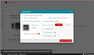

1: when PMIC is working, all LDO and BUCK output normally, if I am using IIC of MCU to communicate with TPS6594, all LDO, BUCK will not output in this time? my EVM doesn't output when I am programming with GUI.

  • Hello Rocky,
    Can you list out your steps on this, so I can recreate this? Was this before after enable, your custom programming?

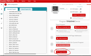

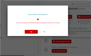

  • Hi, Nicholas:
    1: you can test the LDO1,2,3,4, on programming EVM by GUI. after click "Program Device", until program successfully. please see my picture.
