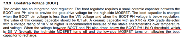

Hi team,
May I know the maximum duty cycle of TPS54336A? Can it work on 100% PWM?
Thanks!
Rayna
Hello Rayna,
Yes, as shown in datasheet, 0% off time as long as Boot cap voltage (Vboot-Vph)≥3V.
But long-time high-side FET on, boot cap will be discharged to below UV threshold. So still you will see SW pulses to charge boot cap.
