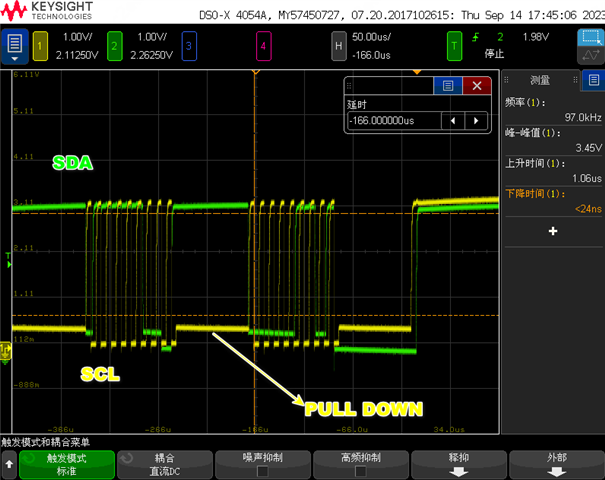

Hi
The customer test with BQ28Z610, When the MCU accesses the BQ28Z610, the SCL cannot be pulled up.
IS BQ28Z610 Supports i2c stretch?
