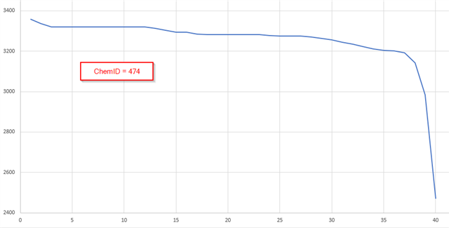

       Please can you advise the chemical ID that has been programmed to the gauge before you do the learning cycle?
    The battery pack is 6Ah LFP (8S2P). Chemid is custom, (0474)

  • Hi Jean,
    The log shows you discharged with a rate of ~C/6 and discharged down to  22552 mV which is approximately 2.8V.
    The chemID you are using has the following characteristics.
    I suggest you charge to full (~3357 mV), this should be the same as the charging voltage stated in cell datasheet. Then discharge to empty. ChemID shows the lowest cell voltage is 2400 mV, you can confirm with the cell datasheet.
    You can try discharging with smaller rate. We recommend up to C/10.
    Please export gg file before and after the learn cycle. This will tell you if Ra updated.
    Ensure that RUP_DIS is not set in the Control status before the discharge cycle. Sending IT_ENABLE command should disable RUP_DIS.
