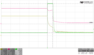

Customer is using the BQ40Z50 on a design and seeing a time delay of 300-400us for an overcurrent event and the activation of protection (CHG/DSG signal change at the BQ). They expected tDetect delay of 160us but they are seeing double that. They set the time offset for 0 seconds for protections.
Is this expected behavior? Any suggestions on how to reduce the time from event to protect?

    Can you share their .gg file and scope captures showing the behavior? If they have large gate capacitance is could take longer to actually see the current be shutoff from ASD event. The delays we give are the reaction time directly when the gauge will start to open the FET.
    Sincerely,
    Wyatt Keller

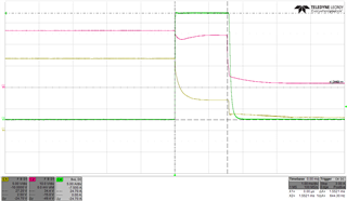

  • Please find attached the .gg file and two scope captures
    • ASCD 24.7A 916delay.png corresponds to the attached .gg file
    • ASCD 24.7A 0delay.png: corresponds to the same .gg file, but with ASCD Threshold2 (line 384) set to 04 (hex)
    • C2 (red) trace represents the DSG signal from BQ40Z50
    • C4 (green) trace represents the current

  • Hello Tyler,
    Based on their settings in the .gg file shared, the AFE Control Register has 0x72, which indicates that the SCD double bit is set (modified from the default setting) so it seems they are intending to increase the delay.
    Base on this, I think the results may be close to the expectations, given 10% error with hardware protection thresholds. Were they triggering ASCD 1 or ASCD 2?

  • Thanks for the quick reply Wyatt. Their gate capacitance is 2nF. Is this considered large or small capacitance for this design?
    From customer:
    It is intended to have the SCDdx2 bit set. With ASCD Threshold 1 and 2 set to 0xF4, the expected delays are 1830us for ASCD1 and 916us for ASCD2 (image below). Because the thresholds are the same, ASCD2 should trigger (lower delay).
    The top limit would be 916 + 916*10% + tDetect =  1168us. What we measured is 1552us.
    Also when setting the ASCD Threshold 1 and 2 to 0x04 (expecting ~instant triggering), we measure a delay of 578us (again, higher than 0 + tDetect = 160us).
    Do you have any insights on what could cause these increases in the triggering delays?
    Tyler
