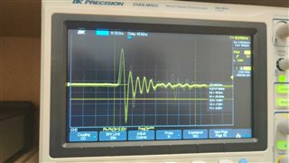

When trying to power a set of 4 motors with the 12V power supply (and this issue has been shown to occur using 1-2 motors as well), we get repeated failure of the output voltage. The image below shows the voltage response measured on an oscilloscope when starting with a single motor load supplied. However, under no load the output voltage correctly goes to 24V.
Initial Voltage Response

Another thing that I saw is that their soft-start time is only about 0.4ms. I thought this might be part of the inrush current problem so I soldered on a 100nF capacitor to increase the soft-start time to about 10ms (which was an interesting experience soldering a THT capacitor to an 0402 component). The oscilloscope result showed that soft-start was working, but we were still getting the same issue.
Voltage After Soft-Start change

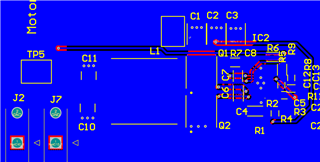

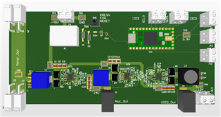

    In the meantime, here's the snapshot of the board layout. I'm including the overall view in case the way the three voltage regulators are connected has any impact.

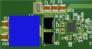

    And here's the closeup of the 24V regulator that we're having trouble with. The blue box is the inductor, the black ICs are the MOSFETS, gray is the LM5146, C1-C3 are the input capacitors and C10/C11 are the output capacitors.
  • Alex,
    The 0.1ohm current sense resistor sounds like the best way.
    Also your placement looks good, and I assume you have a GND polygon shelved, but do you have GND vias on your low-side FET or input capacitors?
    The switching current loop goes from CIN to HS-drain to LS-source back to CIN, this loop area should be small to minimize SW ringing and overshoot.

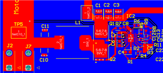

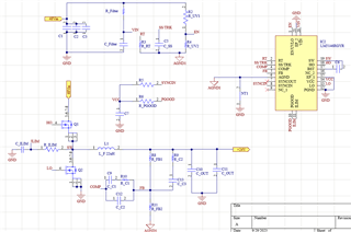

    First off, here's the schematic and board layout for the 24V buck converter module
    Schematic
    Top Layer Layout
    Bottom Layer Layout
