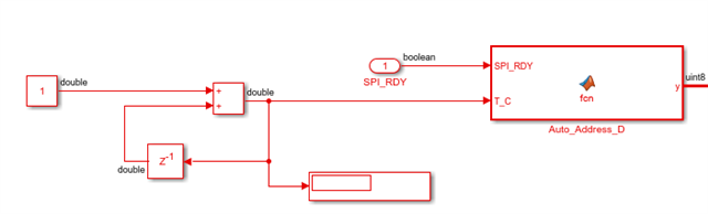

  • Hi
    We are using MATLAB function to do the auto addressing sequence.
    Since it is a model-based approach, the CS signal is automatically pulled down before command is sent and pulled up after the command is sent.
    We have implemented a counter as shown in the figure -
    The counter is to move in a sequential fashion.
    The below function is used to proceed for a single device Auto-addressing.
    function y = fcn(SPI_RDY, T_C)
    if(SPI_RDY==1)
    switch T_C
    case 1
    y=[0x90 0x00 0x03 0x43 0x00 0x25 0x2D];
    case 2
    y=[0x90 0x00 0x03 0x09 0x01 0xD3 0x8D];
    case 3
    y=[0x90 0x00 0x03 0x06 0x00 0x17 0xBD];
    case 4
    y=[0x90 0x00 0x03 0x08 0x02 0x92 0x1C];
    case 5
    y=[0x90 0x00 0x03 0x08 0x01 0xD2 0x1D];
    case 6
    y=[0xC0 0x03 0x4C 0x00 0xF8 0xE4 0x00];
    otherwise
    y=[0x00 0x00 0x00 0x00 0x00 0x00 0x00];
    end
    else
    end
    end
    We got this sequence from the datasheet and EVM user guide, but we are unable to get any response from the slave with the above sequence.
    Do we have to monitor SPI_RDY pin during the entire auto-addressing sequence to send individual read/write commands at each consecutive SPI_RDY highs and lows in the above sequence? or is it enough for the SPI_RDY pin to go high one time followed by the 6 steps shown above?
