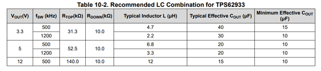

Hi, I would like to have the following design
Input side: fixed 24VDC
Output side: use a variable resistor as the feedback high side resistor, generate variable output 1V - 17V, and 3A.
According to the Webench simulation, the TPS62933 works. However, it requires different component values. The main different is the inductor value.
1. Could l use the middle or largest inductor value to generate 1-17V Vout range?
2. Could I use the largest capacitor C_in and C_out?
Thank you

  • Hello Steven,
    Got it, the thermal at 17Vout-2A shouldn't be a concern.
    But why you has strict IL ripple requirement? If so, you need to use a quite large inductance, the loop stability at low Vout needs to be considered carefully. Below is our recommended LC table, generally larger Vout will have larger recommended inductance.
    If you want lower Vout ripple, another good way is to increase output capacitance, which is an effective way to decrease output ripple.
    To be honest, it's hard to find a golden BOM suitable for all Vout conditions, otherwise we will not list the recommended LC for different Vout. I do see some cases like TypeC PD, where needs 5Vout/9Vout/15Vout/20Vout using same LC BOM. May I know why you have this requirement of your application?

  • Hello Steven,
    According to IL ripple formula, 50% duty-cycle will have largest IL ripple, so it will be 12Vout, not 10Vout.
    The inductance is related to device loop response. Using same inductance for whole Vout range, need to check loop stability in every condition. It's not that easy, need both simulation and bench tests. Please check again the necessarily.
