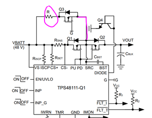

My customer would like to use TPS48111 for their application.
- application : 48V/200A E-Relay with Pre-charge for battery system.
Please review below schematic and let me know your opinion

Hello Rakesh,
Thank you for your interest
Please refer to the below calculator and schematic. Please review below schematic and let me know your opinion.
- application : 48V/100A E-Relay with Pre-charge for battery system.
48V_100A_E-RELAY_230918_R00.pdf
TPS4811-Q1_Design_Calculator_RevB_LS.xlsm
Thank you.
Hi Dino,
please find my comments on design
1. CBST needs to be increased to 1.5uF as you have 8 FETS in parallel
CBST = Total Qg of all FETs / 1V
2. The common source point of back to back MOSFETs should be connected to SRC pin
3. Pre-charge resistor should come before the pre-charge FET and the source of pre-charge FET should be connected to SRC and ommon source point of back to back MOSFETs
4. Separate controller ground and system ground. connect them at single point. Please refer 10.5.1 Layout Guidelines in the data sheet

Hi Rakesh,
The customer revised their schematic as your recommendation.
48V_100A_E-RELAY_230921_R00.pdf
Please review it again and let me know your opinion.
