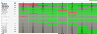

I have a single cell application and DSG-FET is always off state after:
- testing discharge over current limit
- pack side shorted (intentional test)
- reset from bqstudio command
- device is disconnected from battery cell
I have updated FW to 1100_0_05. Calibration is done, cell chemistry is loaded from bqstudio and golden image has been created according to discharge - relax - charge - relax instructions.
After manufacturing enable I am able to set DSG on.. No problems with seal/unseal/full access control.
For me it seems that device doesn't start executing firmware after reset?
Which issue could prevent FW to execute as PF registers are ok?
