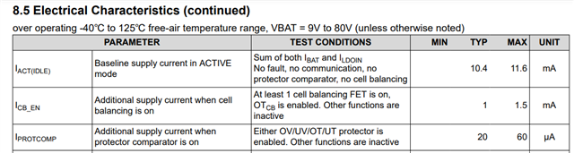

Hi Team
Do you have the date of power consumption of BQ79616 works under active mode while communication is going.
I only can find the no communication date under active mode. Thanks!

Hi Harry,
When the BQ79616 is communicating through the daisy chain in active mode, there is a spike of 10 mA each time a communication is sent:
If you are referring to the TX & RX pins for UART or the GPIO pins for SPI, we recommend 5mA per pin.
Hope this helps!
