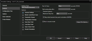

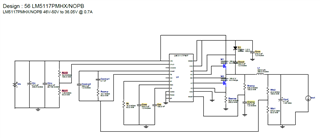

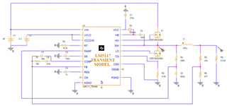

I'm designing a Input=48V, output=36V, 0.7A buck circuit with LM5117. I got the schematic design from webench.
I build the same circuit in PSpice for TI. However, it failed to converge. Auto-converge is enabled. Any idea, please?

Hello Steven
I got an error message when loading DSN file. I am using cadence allegro Ver 17.4.
Usually, this type of convergence error is caused by the MOSFET model not by the LM5117 model. Would you please use a voltage-controlled ideal switch rather than MOSFETs and check if the device model works well or not ?
