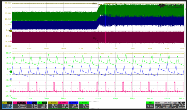

We are now using LM5177 to build a 4 switch converter.
With 50V input / 51.5V output 14A output current using 1mOhm shunt resistor.
We found different behavior between sync pin being pull-up and sync pin being switched (300kHz PWM)
From inductor current, the upper image shows a glitch every 3 switching cycles (100kHz) which matches the PLL refresh rate when using an external PWM signal.
However, with lower images show no glitch with sync PIN pulled to 3.3Vcc under same test condition.
Please help us figure out what's going on with the internal PLL mechanism.
Thanks.
CH1 is output voltage ripple ,CH2 is inductor current

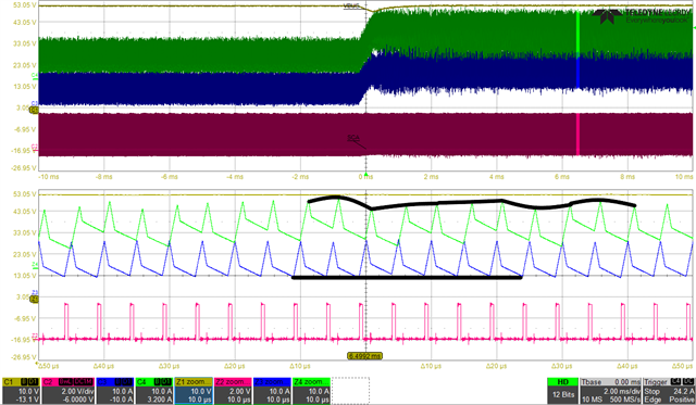

  • Hi Haroon
    I have another test condition with 5 LM5177 being interleaved (72deg per phase).
    CH1 is output voltage.
    CH3 and CH4 are the inductor current of phase 2 and phase 1 with CH2 being Vsync of phase 1.
    The inductor current pattern should be the same with internal Vsync considering output voltage ripple.
    Also, the input voltage is provided using 52V battery pack.

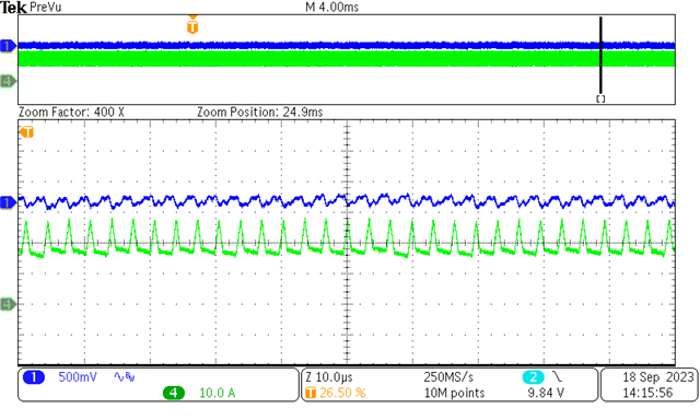

  • Hi Haroon
    Here is another screenshot with same test condition.
    The inductor current (CH4) looks jitter while the other(CH3) dosen't.
    After we found the difference between use external Vsync singal and Vsync pin being pull-up to 3.3V.
    We've try to use only one phase and an external waveform generator(with 50% duty cycle and 300 kHz PWM).
    And the test result is that when using external Vsync sginal,the inductor current looks jitter like the earliest post.
    However,when sync pin being pulled to 3.3V this kind of jitter didn't happen.
  • Hi Chris,
    It seems to me that your input signal to Vsync is not very clean and I see these small noises on it, but let me ask some of my seniors and get back to you.
