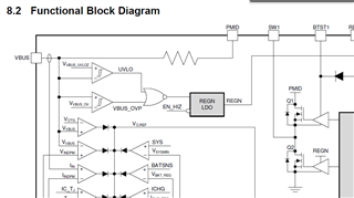

According to the datasheet, I think the Rsns serves as the input current detection. However, this block diagram also shows another element near VBUS PIN to detect input current. So I would like to know the actual function of Rsns.

    The resistor is actually a FET that is used for sensing input current.  The block diagram is an oversimplification.  The resistor (FET) and current loop should be combined.

    Thanks for your answer. About this FET(Resistor), I have another several questions to go further.
    1. So I think the real circuit is the same as below, the Rsns is actually Q1 in this block diagram, am I right?
    2. How to use this FET to measure current? Does it work in Ohmic region to serve as a 6mΩ resistor?

  • Hi Evan,
    Regarding 1, yes.
    Regarding 2, there is a parallel, much smaller FET that is used to measure a scaled down current.
    Regarding 3, unfortunately no. You might consider BQ25798 which has backup mode with OTG at PMID.
