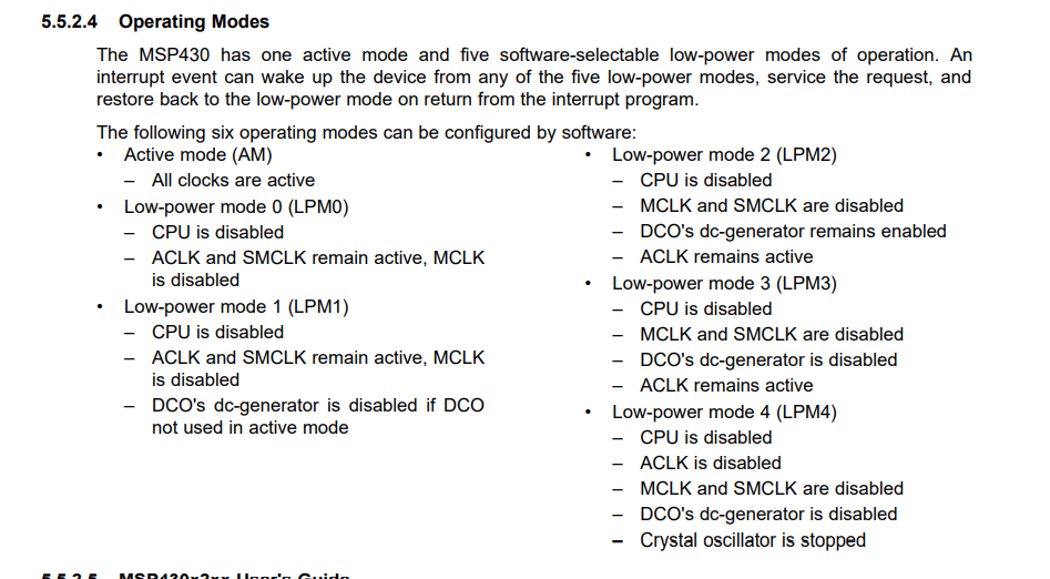

When TPS65835 is in Standby mode, can its gpio port, timer, adc and other peripherals remain in working condition?
Hello DENG,
since this part is not the core of support right now, please allow us some time to review your post.
BR,
Nicholas
Hello Deng,
this is not possible to have all of those other peripherals operational while in the low power mode.
BR,
Nicholas
Hello Deng,
From the datasheet, here are the power states of the MSP430, which comprise the most of your peripherals.
