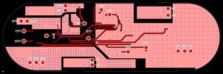

Dear Wyatt,
Thank you for your support.
Could you also review the layout attached below? It is for 3S1P.
Chase
Hello Chase,
Generally the most critical part of the layout is the SRP and SRN connections, they should be kelvin connected, as short as possible, and on the same layer if possible. I would recommend they don't run them through the via they have now and try to keep it the same layer.
Their other power paths look fine to me.
Sincerely,
Wyatt Keller
Dear Wyatt,
My customer modified layout as you suggested. Could you review this layout?
Chase
Hello Chase,
Yes this looks better, traces a shorter and cleaner for SRN/SRP.
Sincerely,
Wyatt Keller
Dear Wyatt,
Is it better to exactly match up the length of 2 lines, SRP and SRN? or is it okay to leave like this length?
Chase
Hello Chase,
SRP and SRN as close to the gauge and equal length as possible is preferred, not required. It looks fine to me.
Sincerely,
Wyatt Keller
