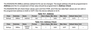

    2- BQ40z50-R5 supports GPIO capability on three LED pins. Please reference to TRM
    3- To program the BQ40zxx IC, you will need BQStudio or a third party programmer tool recommended by TI.
    4- The two devices can be run in parallel. You can change the SMBus address on one of them to avoid conflict.
