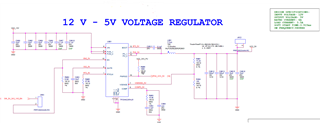

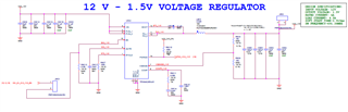

We are using TPS54623RHLR regulator for step down conversions. Please find the below designs. Kindly review and share the feedback.
1. 12V to 5V conversion with current rating of 3.5A, soft start time of 3.915ms, and switching frequency of 840KHz.
2. 12V to 1.5V conversion with current rating of 4.5A, soft start time of 3.915ms, and switching frequency of 491.38KHz.

  • Hi Sathya,
    Rails 5Vout and 1.5Vout look good.
