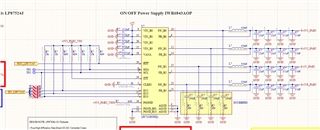

I delevop a PCB with IWR6843AOP a I want to use LP875224J-Q1 to power it without I2C communication. The schematic are the following
I have the following question about this IC:
1. The size of Input Capacitor and Output Capacitor need to be at least 0805 o it could be 0402?

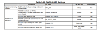

2. If we dont use I2C protocol communication how we can power on and power off the different output voltages? using RST signal o one of EN1, EN2 o EN3?

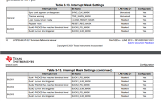

3. In this configuration what date can we receive in INT pin? and in the PGOOD pin?
