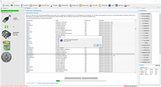

Dear All,
I have designed BQ27Z561-R2 board for battery gauging in our product. I can read register status, change parameters in data memory, send and receive commands. However I fail to write Chemistry ID or Calibrate via calibration window. I suspect error message I receive "No acknowledge from device" has to do something with this. Prior I ignored this message as PC software bug because I have successful communication. But after reading this forum I realized that this message might indicate that default gauge configuration forces it to shutting down.
Can someone help how I should approach this problem and find the cause?
I use EV2300
