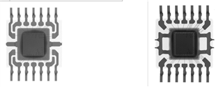

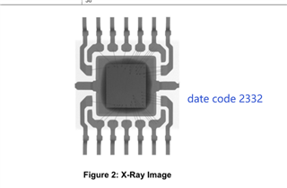

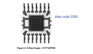

Date code 2023 and Date code 2022 will have different lead frame? please advise.
attached x-ray /PCN for your reference.

Yes, just saw the PCN start with 2023 Feb, so for the new DC 2332 follow the new PCN?
Grace, I am double checking with our packaging team. I will plan to have a response by end of the week.
Grace, your understanding is correct and for DC2332 it will follow the new lead frame.
